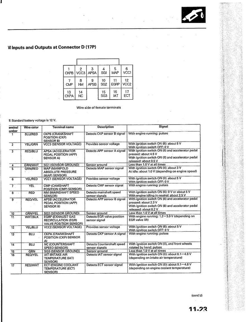

Well, there have been lot's and lot's of people asking me for this. I finally had time tonight to make it readily avaliable for you! This is has been taken directly from the Honda dealer manual. Enjoy I hope this helps all of you out there! :D

dumb question....but say if i were to get a air fuel ratio gauge(yeah i know rice)....what wire should i tap it to.....im guessing the white one? terminal 10 on 11-22.?

Those arent very accurate when they're based off the factory o2 sensors, to be safe and accurate, you want an aftermarket wideband o2 sensor....$$$

yeah thats what i figured with the voltage above 1.0 ....well thanks n e ways.
