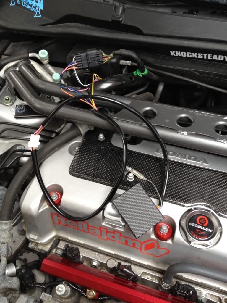

The first problem is the location of the DBW plug. Unlike in the 8th gen accords, where the plug is simply above the gas pedal, in 7th gens it is in the engine bay, on the left side. Very far away from the driver.
I apologize for not taking pictures of the modification process to the harness. I was in the zone and didn't want to lose momentum. It entailed re-pinning and splicing and almost an hour of cross referencing and double checking. I didn't want to fry my ECU by sending power, signal or ground to the wrong point and I had 12 of them to re arrange.

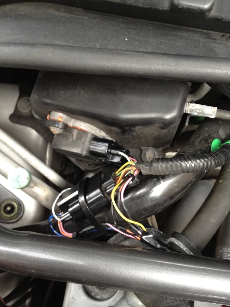

This is how I plugged in the harness.

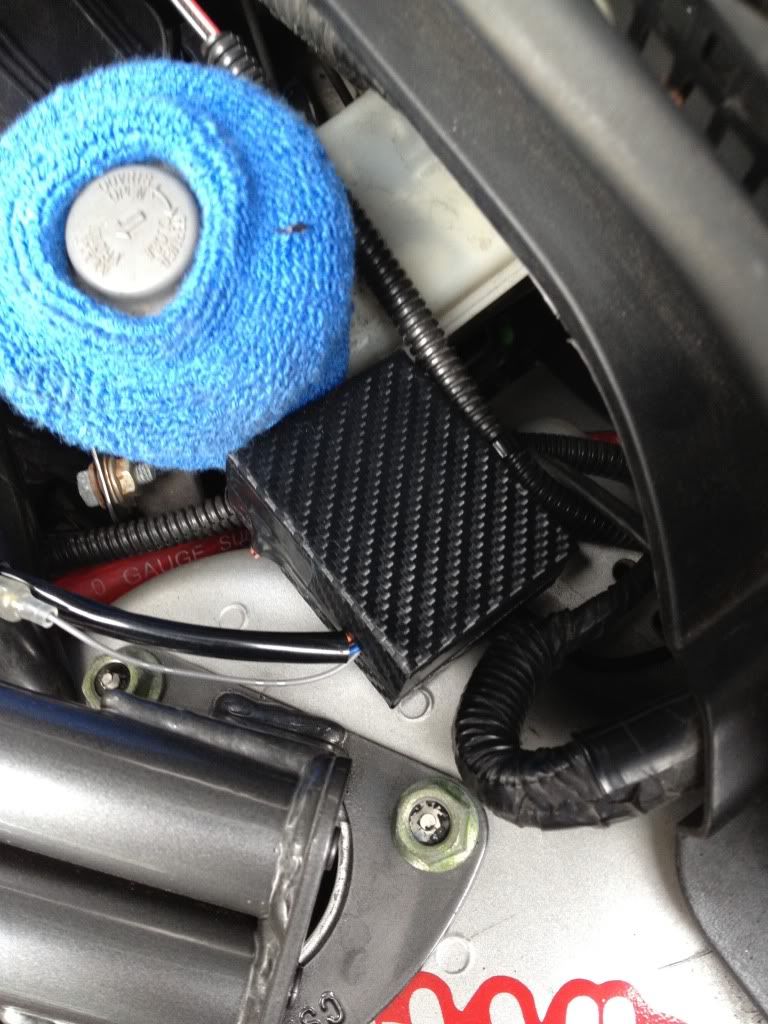

The box on my engine is the brain. I wrapped it in carbon fiber to make it more esthetically pleasing. The harness shown below is quite secure.

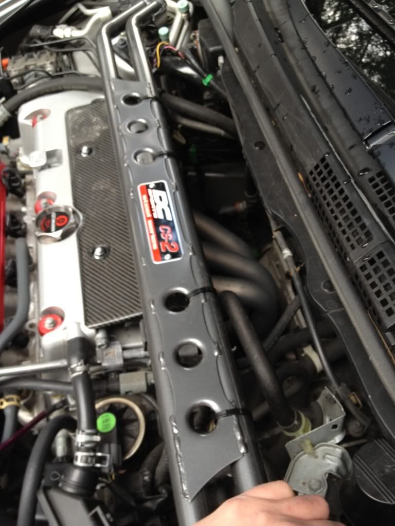

Using my strut tower bar, I tucked the wiring behind it and zip tied it.
After running the wire for the controller through the firewall, I made the final connections and secured the brain. You can see one of my 3 runs of 0 gauge tucked in there.

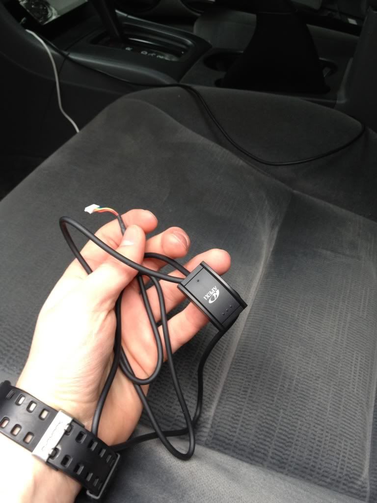

This is the tiny control module.

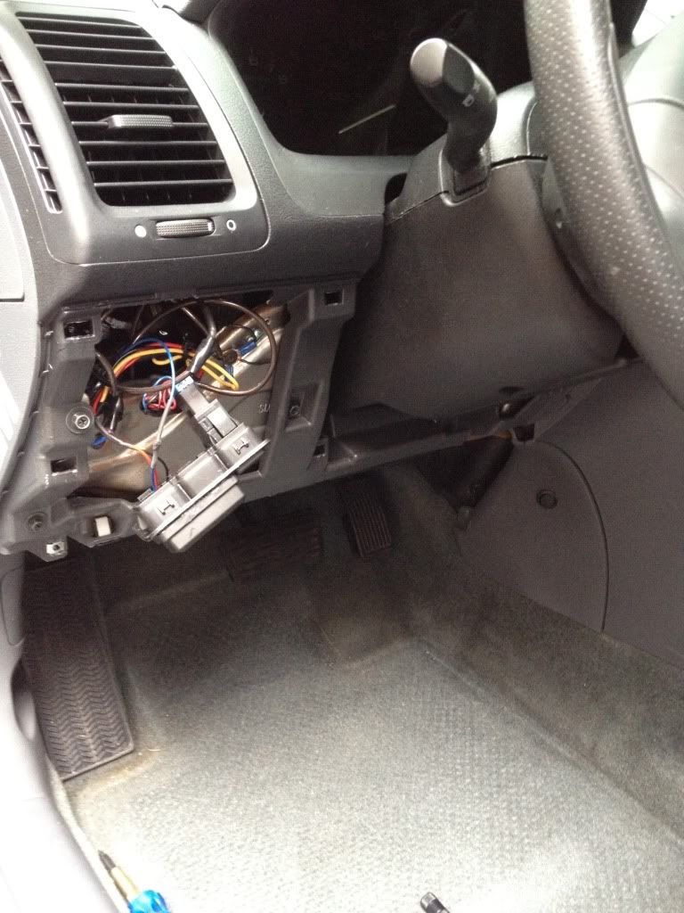

I was going to, and probably still will wire the controller to the panel that is dangling. Unfortunately all three slots are occupied at the moment with the fog light switch and my volt meter. The switch on the lower part of the center console is for the volt meter.
Without extending the harness, I was limited in my mounting options. I will extend it and eventually mount the controller somewhere near the shifter.
For now, this positioning will suffice. It is secure and allows me to see the unit while driving.

I'm talking about the DBW harness. It is not PNP at all, they don't make a harness for 7th gens... only 8th gens and in order to make it work it required re-pinning. But instead of doing that I cut/spliced to not ruin the fragile connectors. Yes the plugs are the same, but if you do not re wire, it will not work. It can't... on the 08 harness, signal and power are reversed on the male side and power and ground are reversed on the female side...
plus the controller harness has to be extended. and anyway, this is far to complicated for it to ever be PNP... on the 8th gen yeah it takes 30 seconds. But if you got one to work on your accord... without changing the wires... this was all necessary?
