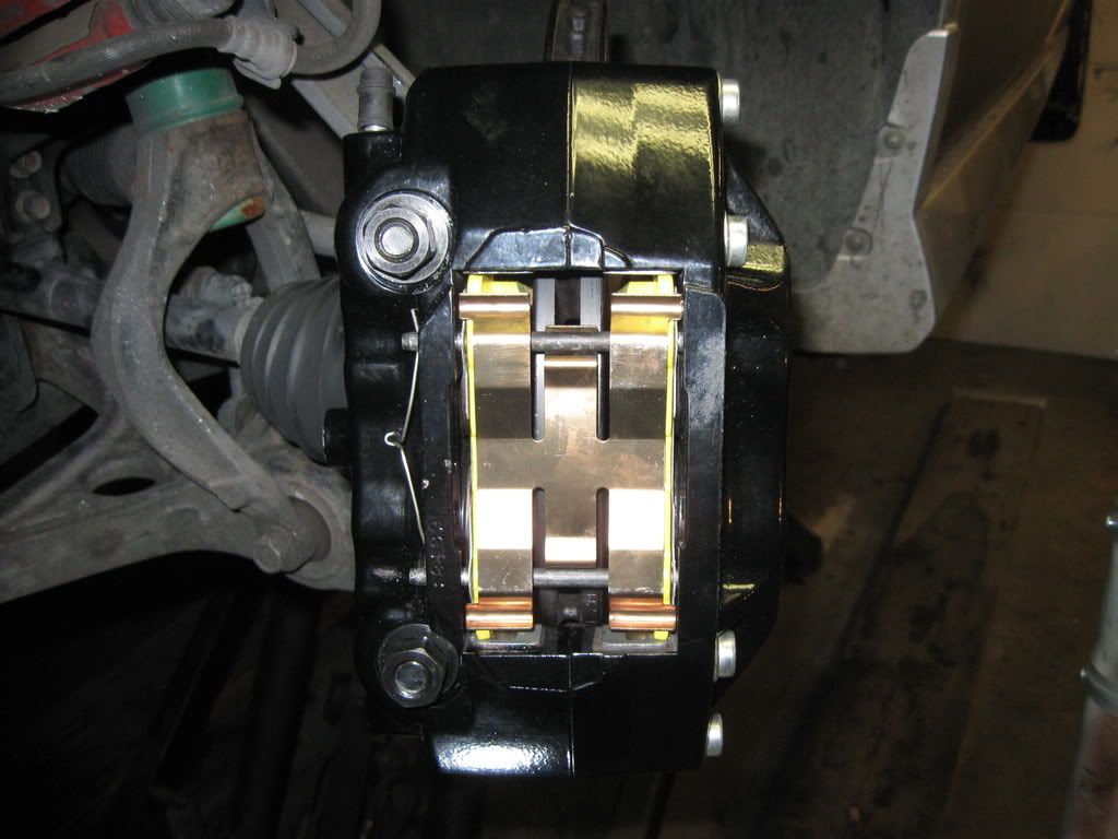

Hey guys, I just got done fabbing up some caliper mounting brackets for Kai (Kschwiggy) and thought I would share:D
Pair of 05+ RL 4 pot Advics caliper off ebay $200
Pair of rebuild kits from Acura $100 (so they could be powder coated, rubber doesn't like 450F)
Pair of Rotora (RD.40036.A.330.01S) 12.8" rotors (not sure what he got them for)
EBC yellow pads.

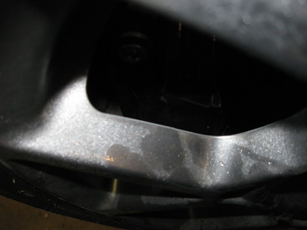

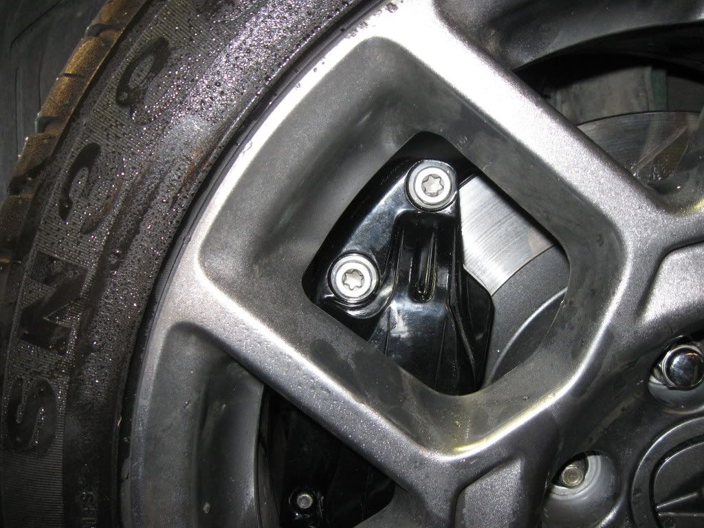

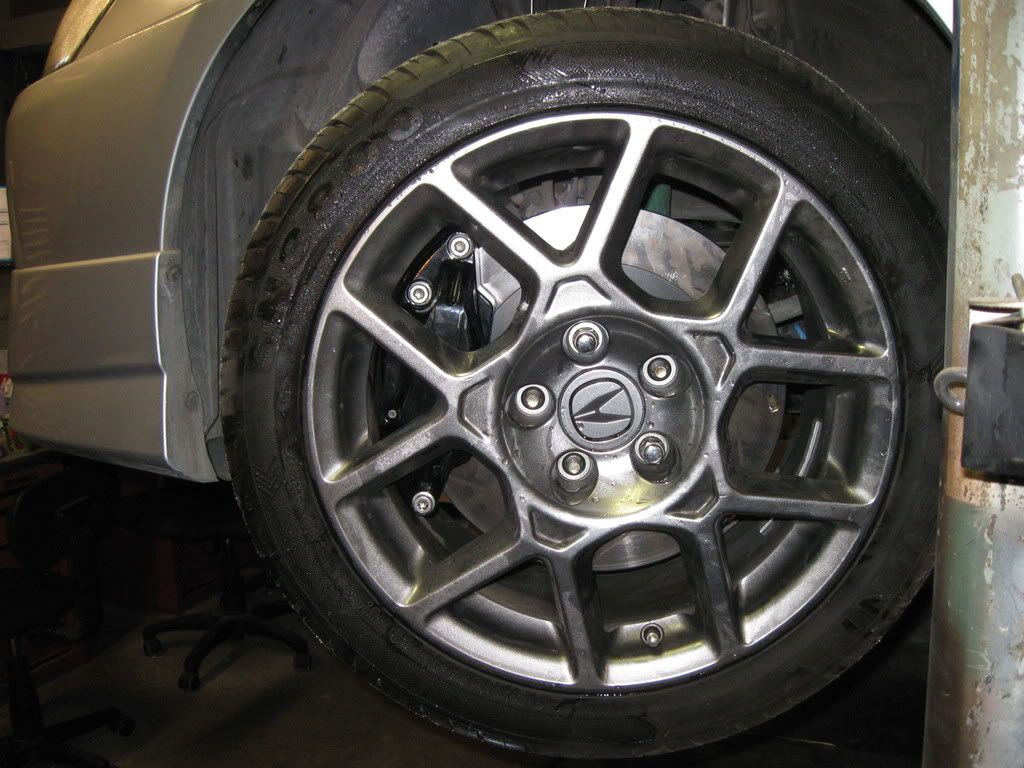

These cleared TL Type S 17" wheels with no issues, but will not clear stock 17" due to offset, you would have to add a 15mm spacer to get the stock 17" to clear.
EBC yellow pads.
These cleared TL A-Spec 17" wheels with no issues, but will not clear stock 17" due to offset, you would have to add a 15mm spacer to get the stock 17" to clear.
Nice work, very innovative. Just a few additional notes for clarification since it will help others out.
1. The ROTORA discs should have the slot facing forward, towards the front of the car.
2. I am pretty certain those are TL Type S wheels. The TL base wheels and TL Type S wheels both clear the factory Brembos available on the TL M/T or TL-S (A/T and M/T both get Brembos). I believe the A-spec wheels are 18".

I did not care at the time what direction the slots were facing, just wanted to do a fitment check. And yes they are the Type S wheels, my bad.

Not sure what other rotors have the same specs as far as offset, but you could go larger, say 13", 13.2" by simply adding a spacer between the caliper and bracket.
