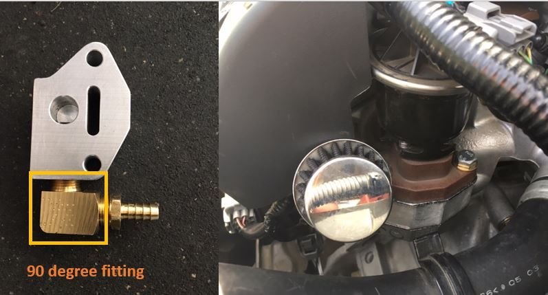

Picked this up from NSWDoc and installed it. Pretty straight forward. I found the positioning of the air filter with a straight adaptor didn’t work for me due to some other wiring and brackets on the block so I added a 90 degree fitting.
I have also purchased the kit and am scoping out the install. My plastic engine cover has been removed (cuz it's a racecar:D)but the bracket is still there holding the connector to the O2 sensor. I think I can just cut the "ear" off the bracket and install the bypass filter without an elbow. I'm also considering where to mount the filter in a remote location...
