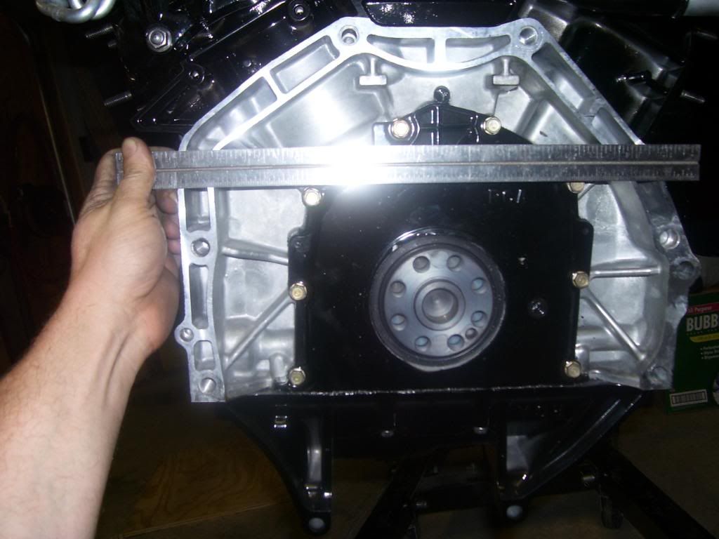

Acura TL J32a3 07-08 *I call this version 2 because of the changes in the bellhousing (not a direct fit, must swap in bell housing from Accord gen8 accord 2008-2010, must repin the injectors or use stock 270cc, and also must swap IM if AT)

2003-2006 Acura MDX J35a5 (not a direct fit, must swap in bell housing from Accord gen8 accord 2008-2010, must repin the injectors or use stock 270cc, and also must swap IM if AT)

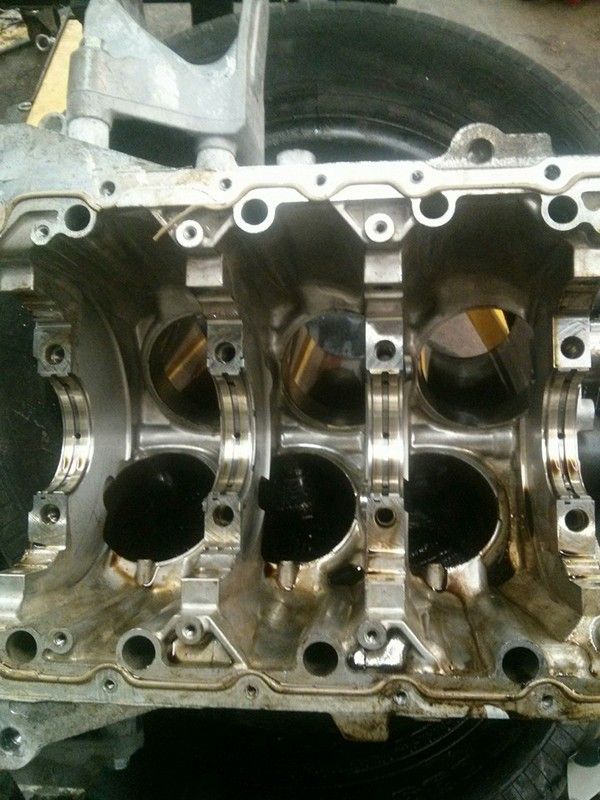

** Note no oil jets on the J35a5, Credits goes to Michael William Gonsalves for the pix

2005-2008 Acura RL, 2007-2008 Acura TL Type-S J35a8 (not a direct fit, must swap in bell housing from Accord gen8 accord 2008-2010, must repin the injectors or use stock 270cc, also must swap IM if AT)

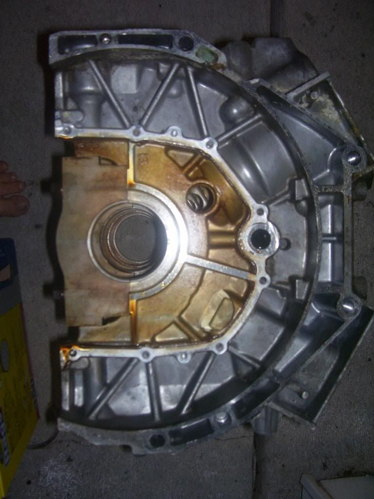

MT Transmission
J30a4 and J30a5 direct drop in but does not have LSD for motor J30A4, J30A5, and J32a3 version 1.
Borrowed from Paul photbucket

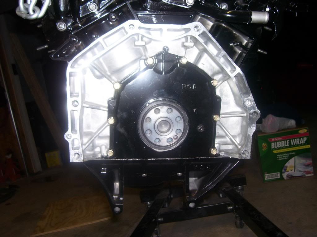

J35a8 direct drop in and has LSD in J32a3 version 2 block 2007-2008, J35a8, and maybe J37a variation **unknown**
Borrowed from Paul
belt housing part number to get it to fit j35a8 block 21000-RDE-305 **Correct as of 3-1-16
