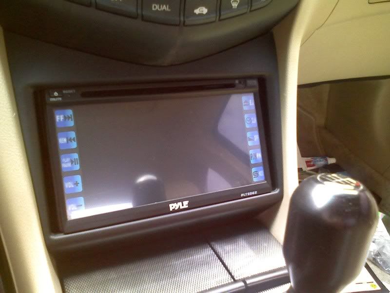

I have a DVD player I want to put in the cubby. I have everything I need to mount it but I need help with the wiring. This is a '03 Accord btw. I'm wondering where to tap power from. And also, I don't want to replace the stock unit but I do want the sound from the DVD to player through stock unit (AUX) and speakers... Someone mentioned a high-low converter but I have no idea wtf that is. I have the audio attachment cable (for optional MP3 or CD Changer) and I was wondering if there was a way I could guess and check the wires to find the audio output... :confused:

well if you are using that as your audio source why not just unplug the blue honda harness, extend it, and wire it to your pyle dvd player so the sound is directly through all speakers and you dont have to worry about messing with the stock radio
