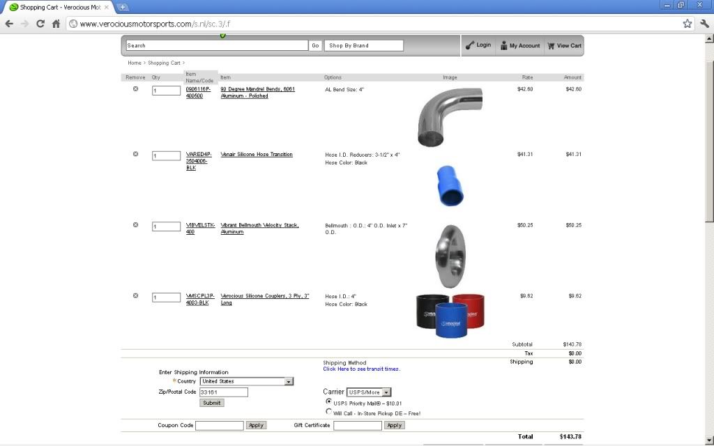

Wutup just wanted to show a screenshot of everything i will be using to do some dyno testing of a custom 4 inch Short Ram intake i ordered recently, as usual i will be doing multiple testing on the same day changing parts on the dyno to get accurate comparisons :up:, ill keep everyone up to date on the progress :up:

make sure you get more length on the piping to simulate cold air as a test also.
I've done this test also and I gained more power with a cold air+ velocity stack... I actually gained close to 20whp more, and 15+- foot pounds of torque. Better low end, and top end. the length of piping helped increase velocity. What I ran was a 3" tapered to a 3.5" to a velocity stack all conical transitions with expanded piping welded.

will do, i just want to see if there is anything i gain from switching over to a bigger intake, and i will be keeping a short ram becuz i dont have splash guards....

yup it will prolly take a week to get to me but the good news is this is a DIY kit basically but you will need a small battery or relocate it, i am optimistic but its basically a gamble but i hav spent money on mods before that basically made me slower so this type of testing is no biggie
