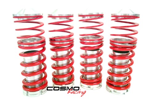

well I have KYB - GR2
and EVO II dual coilover kit from cosmoracing.com
at first I thought I was gonna bounce everywhere
installed them and they did not fit / grip the rear shocks
so I spoke with the company and they gave me a larger - longer rear sleeve set
that solved the height issue, because I was riding on shocks - the coils were not even compressed :eek:
so here's the setup
8 KG / MM 7" coil in the front with the secondary top coil for added stiffness
6 KG / mm 6" coil in the rear with longer sleeve and the secondary top coil as well
I am very impressed how stiff they ride
if you are planning on doing your suspension and wanna save money and still have a professional drop and not bounce .. get this
just an FYI - EIBACH and NEUSPEED use the same KG / MM ratio :)
