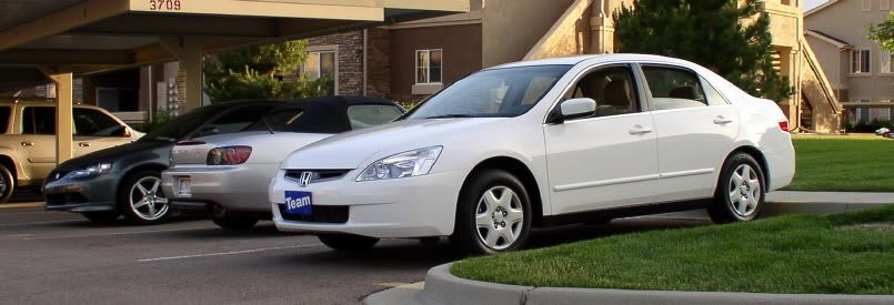

We got this about a month ago. So far it seems to do pretty well considering the elevation we are at (5500-6500 feet). The day after we got it we shaved the emblems off, put two coats of Zaino on, took the resonator off of the intake and I cleared the headlights. A few weeks later we got the windows tinted. Today I put on H&R springs, but I think I missed a step. Can you tell what it is? :)

I really like how your car looks with the headlights cleared - Makes your car look much sharper! How'd ya do it?
You should get the painted side trim also.. it'll make your sides look more even with the front and back.

There are probably directions on here somewhere on how to clear headlights. Basically you heat them ( I do it in the oven at 215 degrees), pull them apart, remove the reflectors, and put them back together with a fresh seal of silicone.

Good eye! I didn't even realize that they disappeared in the pics until you mentioned it. It would definitely look better painted.

Looks clean with the new RSX rims.

Looks clean. And I was going to recommend the EX side skirts also..... they're about $220 for the pair.
What are you missing? A camber kit!?

I still haven't had the camber checked yet, but if I find that it it is way off, I will definitely buy a camber kit. :up:

Nice car have the same model and same color myself. I brought the car in for an alignment and the front was right on. The back needs the kit though,,,its off ,but not that bad. I just painted the side skirts mysef and they cam out great. Color match from Pepboys autoparts.
