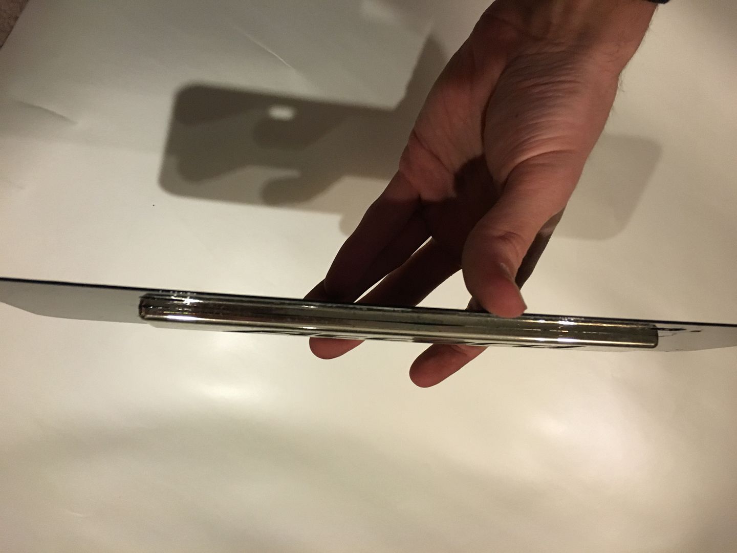

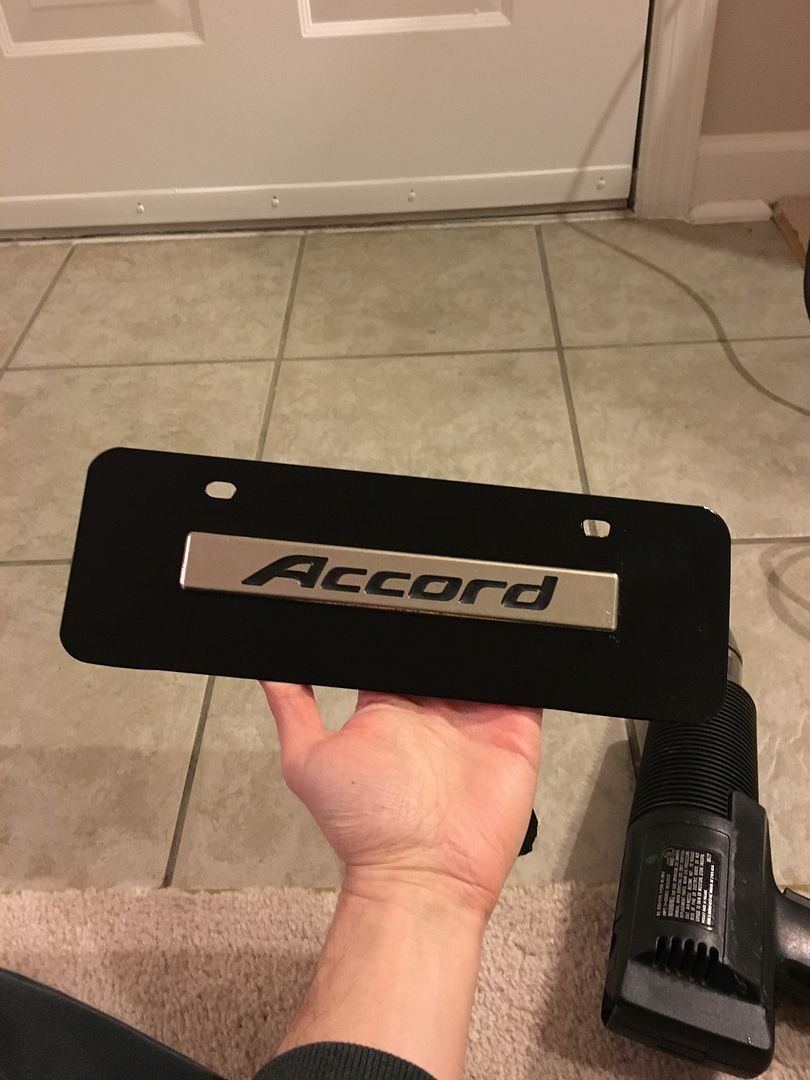

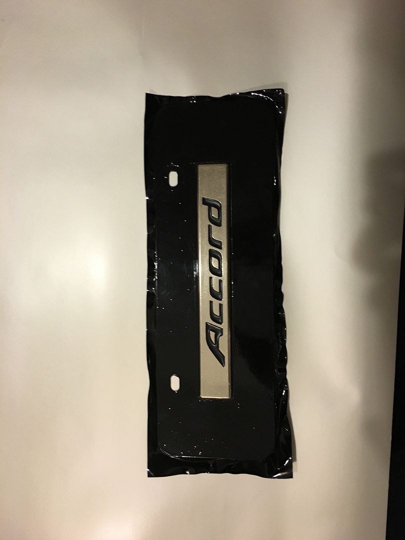

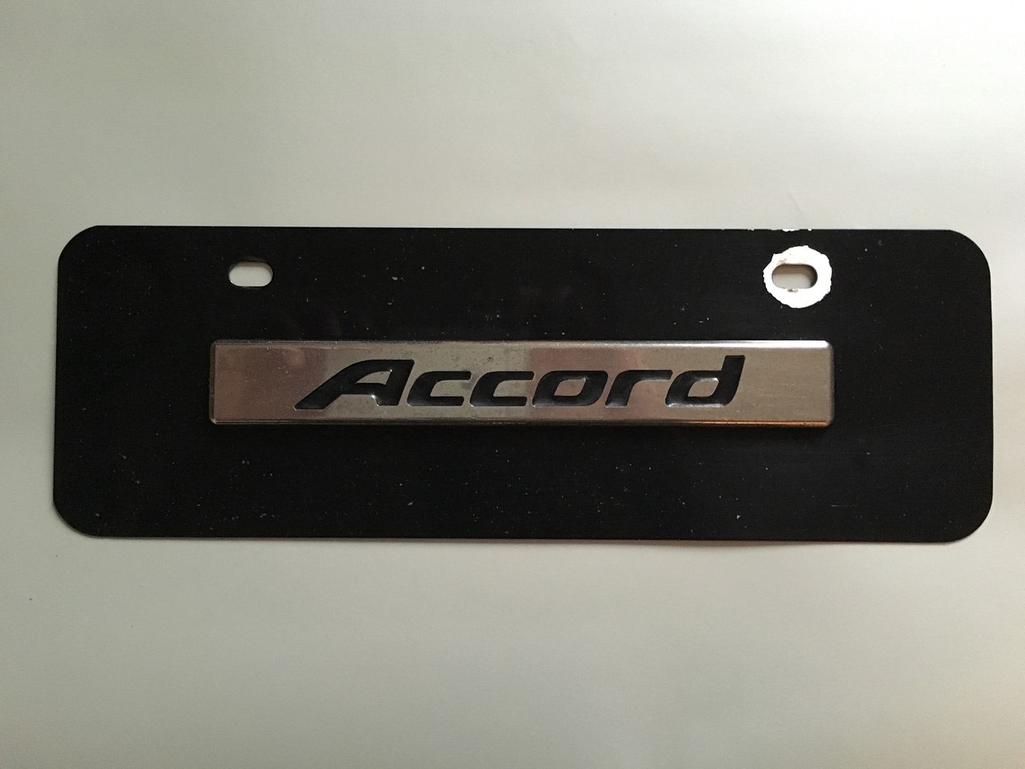

I started practicing my vinyl wrapping skills last night. Thinking about peeling the dip off and wrapping the car after winter. Practice makes perfect, right? It's not as easy as it looks (just FYI) ha
This is my 2nd front plate, as the first one had to be replaced due to chipping paint, and once again...same issue. o_O
So what's the solution? Let's wrap that beeotch! :D

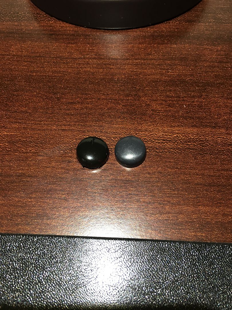

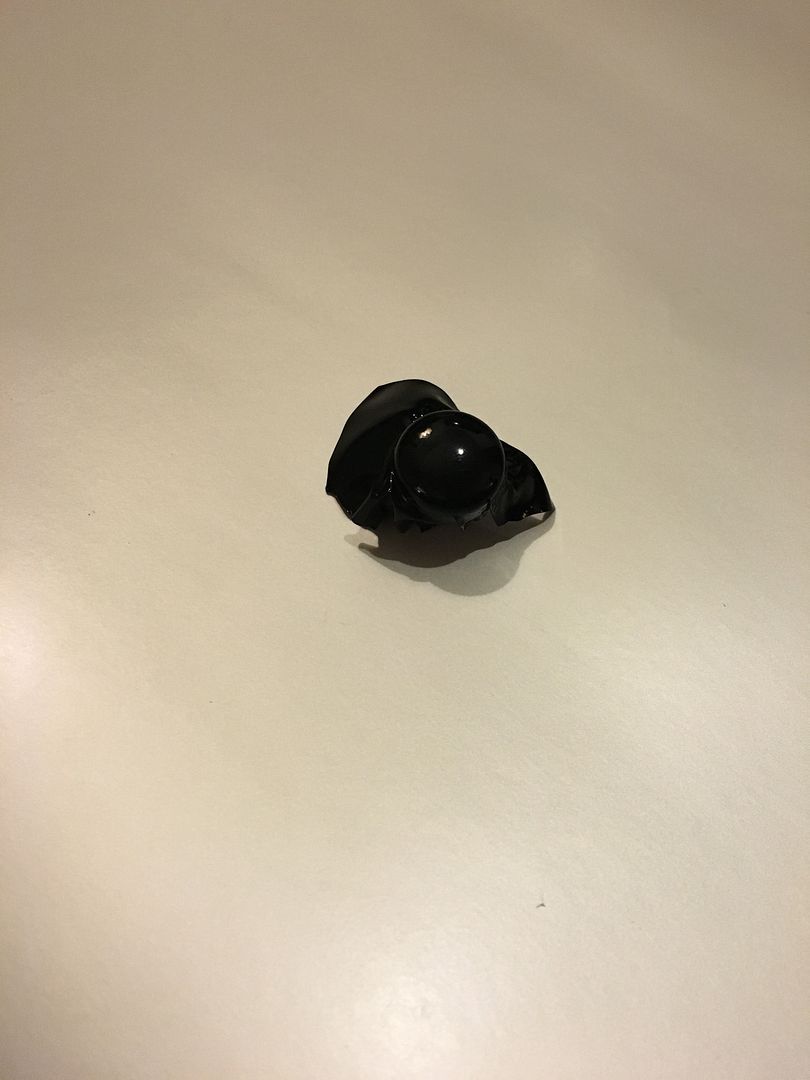

Wrapped VS Unwrapped screw covers:

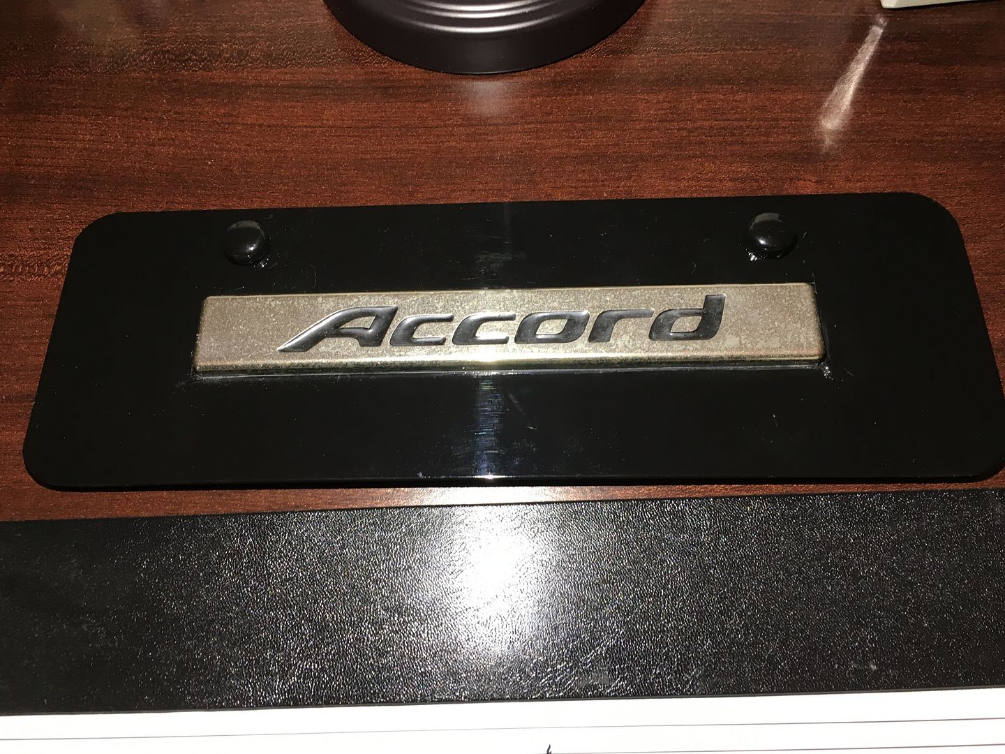

Final outcome:
