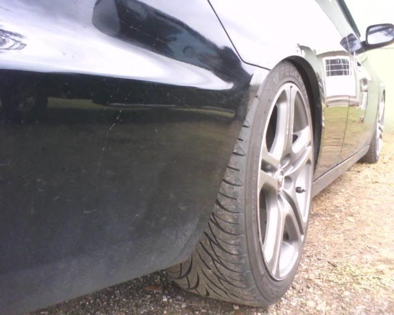

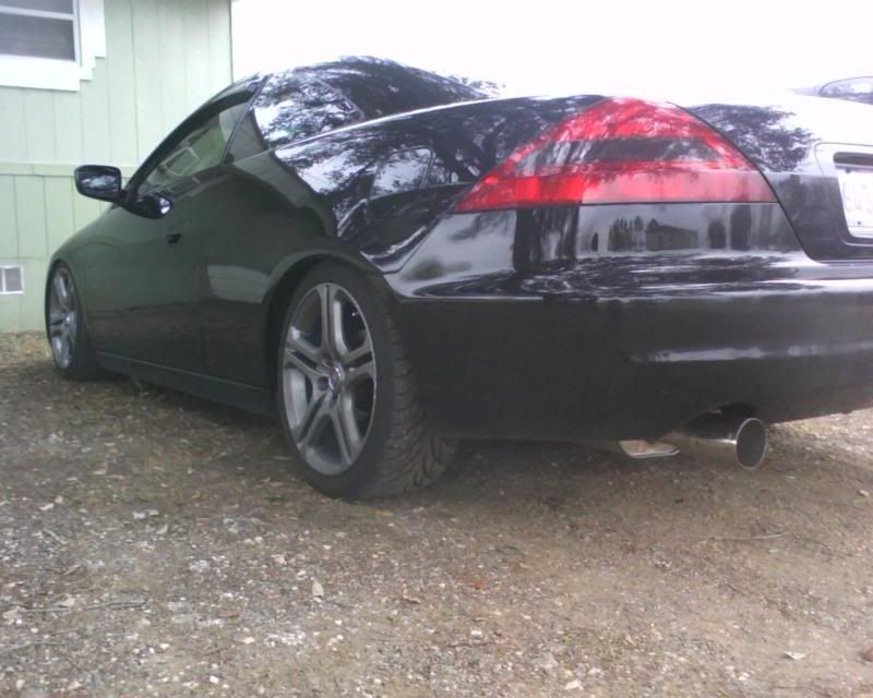

Wheels: MB Wheels Battle Gunmetal 18x9.5" +23F +15R
Tires: Falken ZE-912 225/40/18
Fender mods include:
Front fender liner trim
Front fender liner braket bend-back
Rear fender roll (FULL)
Rear bumper attatch bracket bend-back
Rear bumper trim
**NO PULLING** <------Very proud of this
