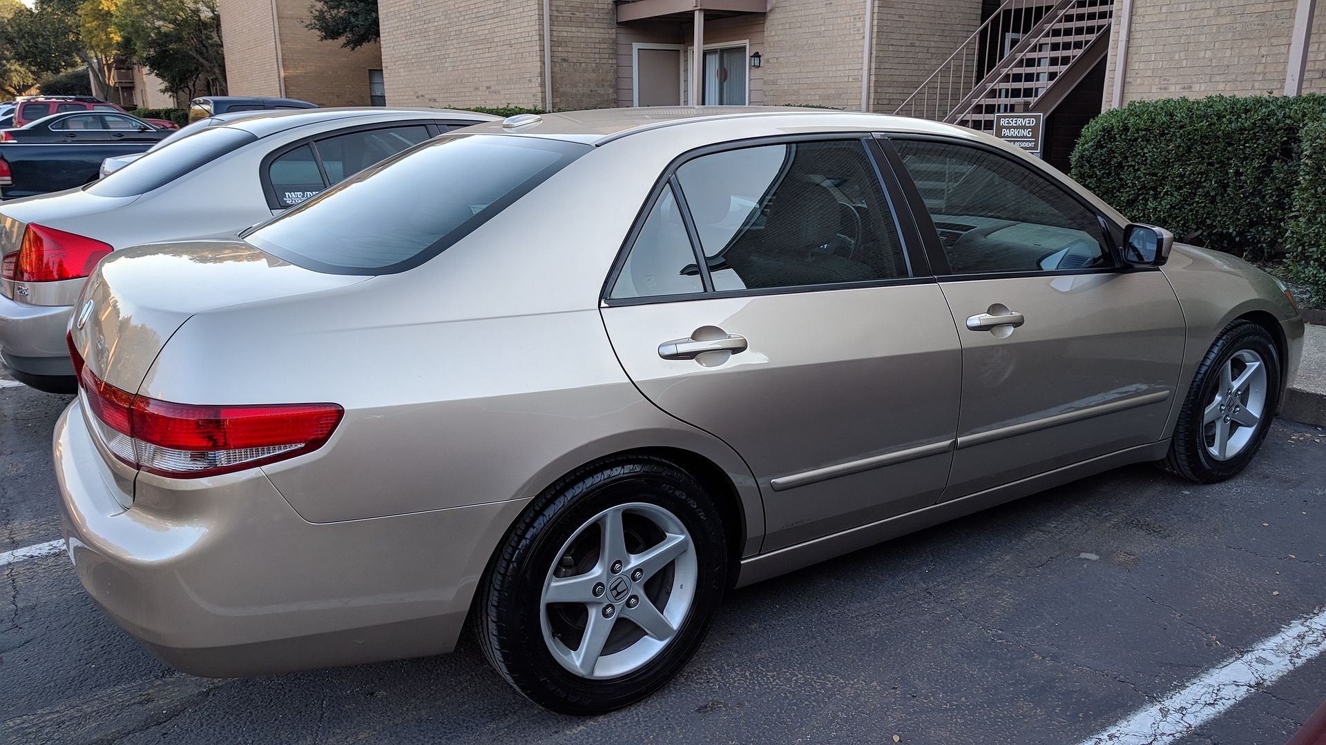

Just bought her Saturday so I changed air filter, changed spark plugs, speant hours renewing the headlights.... That was rough but they look new! Also reset ECU and was happy the previous owner put the radio code in the book lol. Excited to be a member and owner!

Not much activity on here anymore :(. Since picking up the car on Saturday I have also changed all brake pads, put on new rotors front and back and cleaned up and greased the caliper pins and boots. I flushed the trans fluid and put in GM syncromesh. I replaced the intake hose after I found a crack.
