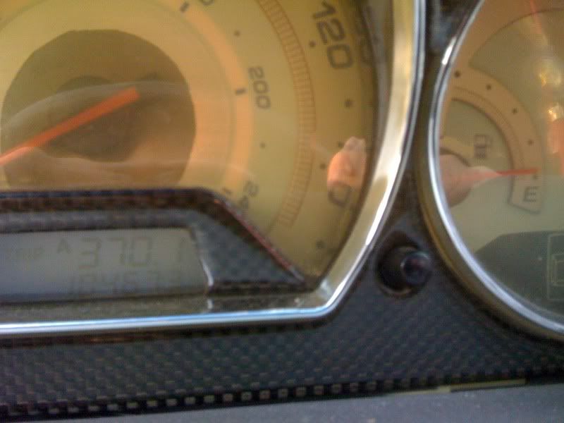

for people who got the swap, do you guys get this much mileage too?
I'll fill her up maybe about 15Gal, from then on I'll get 420+ miles from her on the freeway and around 350+ on street/frwy before the tank get's empty. Is that normal? What grade of gas do you guys put? Is it awesome to get that much mileage? feedback asap...
