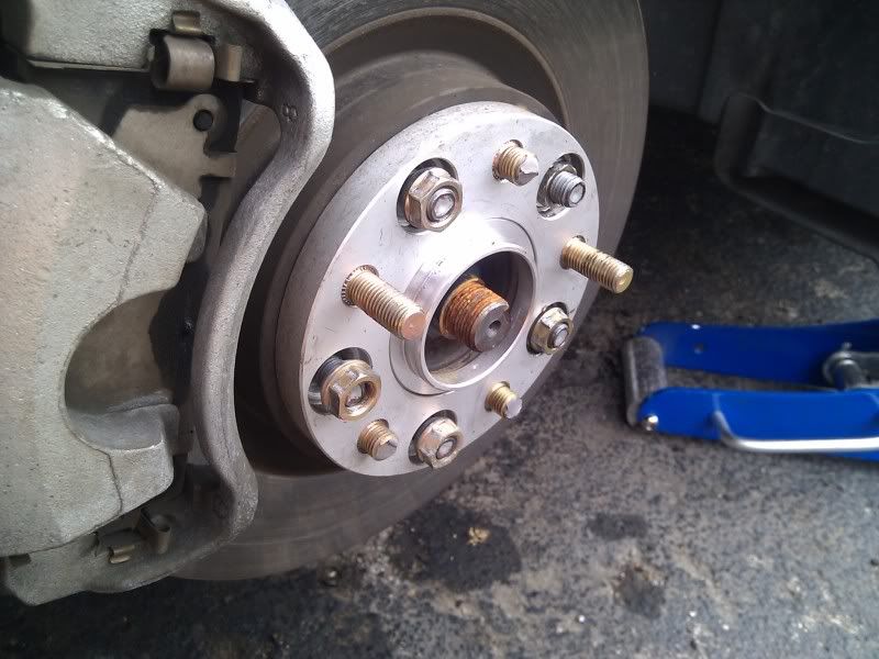

My buddy got some ebay spacers and looked what happened today... FAILED.
Broke three studs while driving..
**AGAIN THIS ISNT MY CAR.***

#10 ·
horrible
this spacer looks to me like the stock wheel studs sit taller than the spacer itself while installed? so when the spacer is mounted, the stock studs still protrude out. It's possible this set of spacer is designed for a vehicle with shorter factory wheel studs or intended to be cut by the installer. So the installer to me in this case, installed the spacer, noticed the stock studs were longer. The installer than still mounted the wheels and drove off without making it properly fit. I say installer error. Not faulty product.
Just my opinion from what I'm noticing. Feel free to correct me if I'm wrong. You get what you pay for, and sometimes you pay less so you have to do some extra work like cutting the stock studs!
I am sorry that i blamed the faulty of the product. You are correct nighthawk04v. Now that you have pointed out the problem i see why and what was the outcome.
#20 ·
I checked out his wheels last night and the wheels was protruding on the studs. He did not take note on the extra clearance.
Dammit! and I was already on the fence about gettin spacers... lol
Well, I would blame this all on my friend. Very stupid install on his car because he had steely with these wheel spacers. I just automatic thought it was the "ebay" brand because he did say he got them from ebay.
